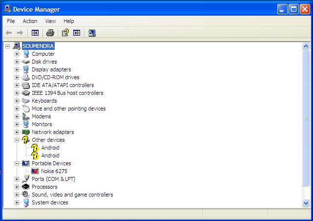

Windows XP Unable to Install Serial Port driver Qualcomm HS-USB Android DIAG 901D (COM11)
  • Mobile Set: Qualcomm MSM 8610 (Flattened Device Tree), Android 4.4.2, Build Name: E619_Haier_Reliance_S07.
  • Desktop: OS Microsoft Windows XP Professional, Version 5.1.2600 Service Pack 3 Build 2600.
  • Reliance Haier E619 Debugged.
I have downloaded E619_Haier_Reliance_S06 drivers as well as Haier_E619_USB_Driver from http://haiermobiles.com/software-drivers/ and http://haiermobiles.com/index.php/download-software-and-drivers respectively,
then followed the steps for driver installation from the guide available at the URL http://haiermobiles.com/software-drivers/E619_S06_SD_Card_Version_Download_Guide_Final_5Nov2014.pdf
but when I select the relevant location of the downloaded drivers in my PC, XP unable to install the device.

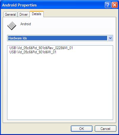

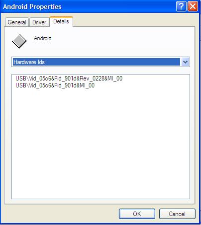

In device manager, I can see Hardware ids for the devices as follows:-
USB\VID_05C6&PID_901D&REV_0228&MI_00
USB\VID_05C6&PID_901D&MI_00
USB\VID_05C6&PID_901D&REV_0228&MI_01
USB\VID_05C6&PID_901D&MI_01
I have successfully Updated the Android System of said Mobile Set, enabled Developer Mode and Debugging, where the User Manual of the Mobile set mentions, "You need to plug using the data cable to the computer to use handset for data connection sharing through USB port" but Its not working with my PC. I have visited relevant Haier Service Centers, also written to Haier Service Head but they have been ignored to address the issue reasonably.
1. Can anyone please guide me in installing the devices?
2. Do I need to download specific driver/s for the same?
Please guide me to install the USB Cable successfully so that said Smartphone can interact with the PC.
Thanks

You need to get hold of any working QPST drivers....lets say for galaxy/nexus....In the INF files, you need to replace the PID and VID.
Looking a the screen shots....i think if you need qpst....you need to enable it from adb using setprop....but you need adb first.
If you are not abel to find adb drivers, then get the generic google usb driver.
