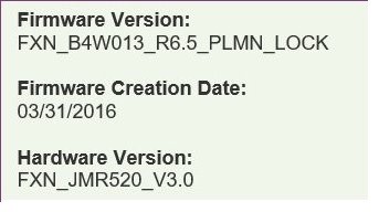

hello, even i am facing some issues with my JIoFi 2 device. 4G network goes away automatically after 50 odd minutes. Can anyone tell me what is the latest firmware version of this device? Also is it available on internet?, if its available please provide the link. Can i update it manually at my home?, or i have to take this device to service center for firmware update?
Hardware and software version of My JioFi 2 device are:
Hardware Version: FXN_JMR520_V3.0 and Firmware Version: FXN_B4W013_R6.5_PLMN_LOCK
This is the latest firmare version  Firmware Version:
FXN_JMR520_R6.24
Firmware Creation Date:
10/05/2016
Hardware Version:
FXN_JMR520_V3.0
Post this update all seems to work fine
