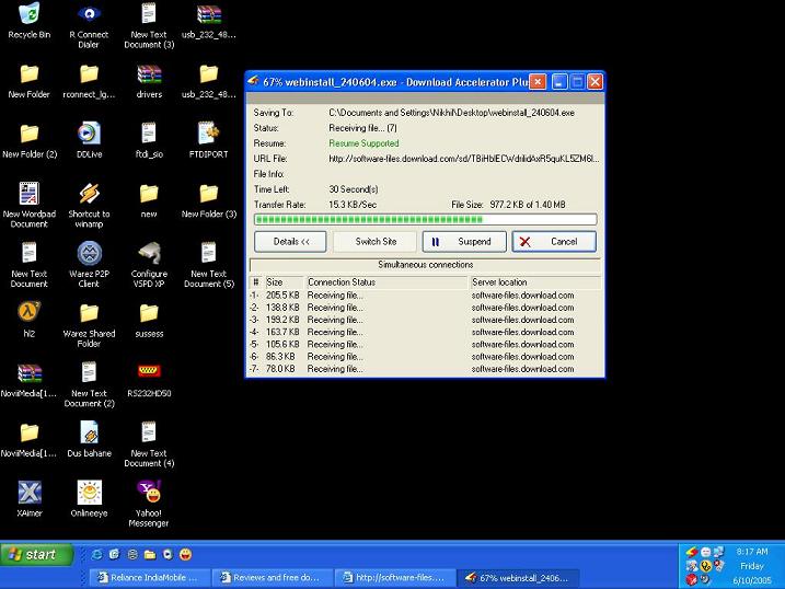

any way for lg mobiles connected at 115.4kbps using any cable grey or original
the downloading speed for me was not going above 10kbps. while the average speed was just 5-6kbps.
trust me after this method i selected the baud rate on my lg phone to 230kbps
and the connection was made showing 230.4kbps.
now for me the average downloading speed is about 10-11kbps.

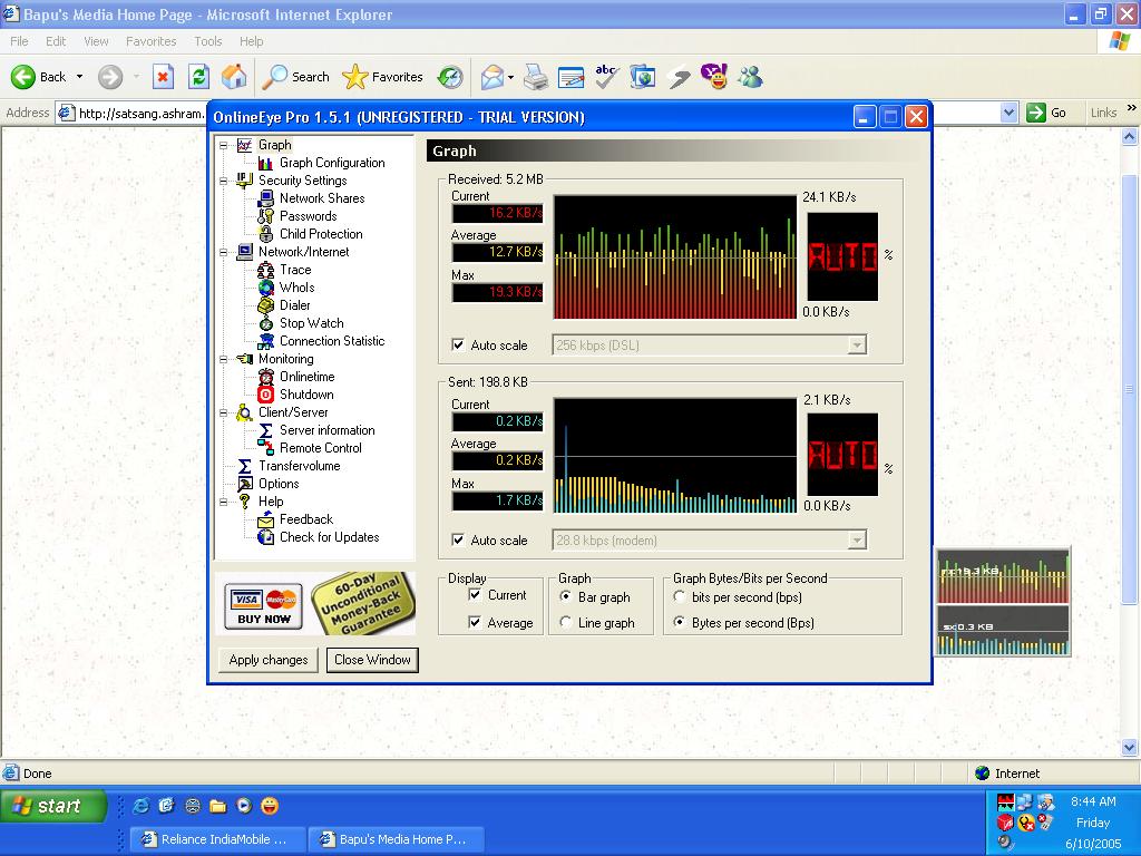

As I said PLEASE DO NOT GO BY WHAT WINDOWS REPORTS. ITS INCORRECT INCORRECT INCORRECT.
Let me give you an example on a dial-up connection using IE download a file. When the "save as" option opens wait for 2 minutes before clicking on the "save" button. As soon as you click on it you'll see your download speed showing around 10x and then it gradually goes down to the correct speed. Something similar happens here too.
Download a good program for calculating bandwidth usage... like the one PC Mag has ... I've forgotten the name.. and see for yourself!
Name of the software is NetperSec. And be careful about kBps and kbps!

Average Speed = 12.7 x 8 = 101.6 kbps
Max Speed = 19.3 x 8 = 154 kbps
So where is the 230 kbps? CDMA supports upto 155 kbps... though you occasionally see a burst upto around 163kbps.
