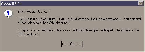

Actually static U think u've got something wrong reboot and offline are I suppose only in test version and not .62 here im attaching a file of .62 I use only .62 with .7 I get many errors
I want to load new ringtones to my RD 2030 set, I've connected my mobile with the computer using my LG USB to serial connector cable bought from Reliance Webworld. But BITPIM software is not showing any files, as i expand the / folder. What is the reason.
yeah i have got Version 0.7 TEST 1 ... which i am using since october 12 2003.
it does not support offline and reboot.
