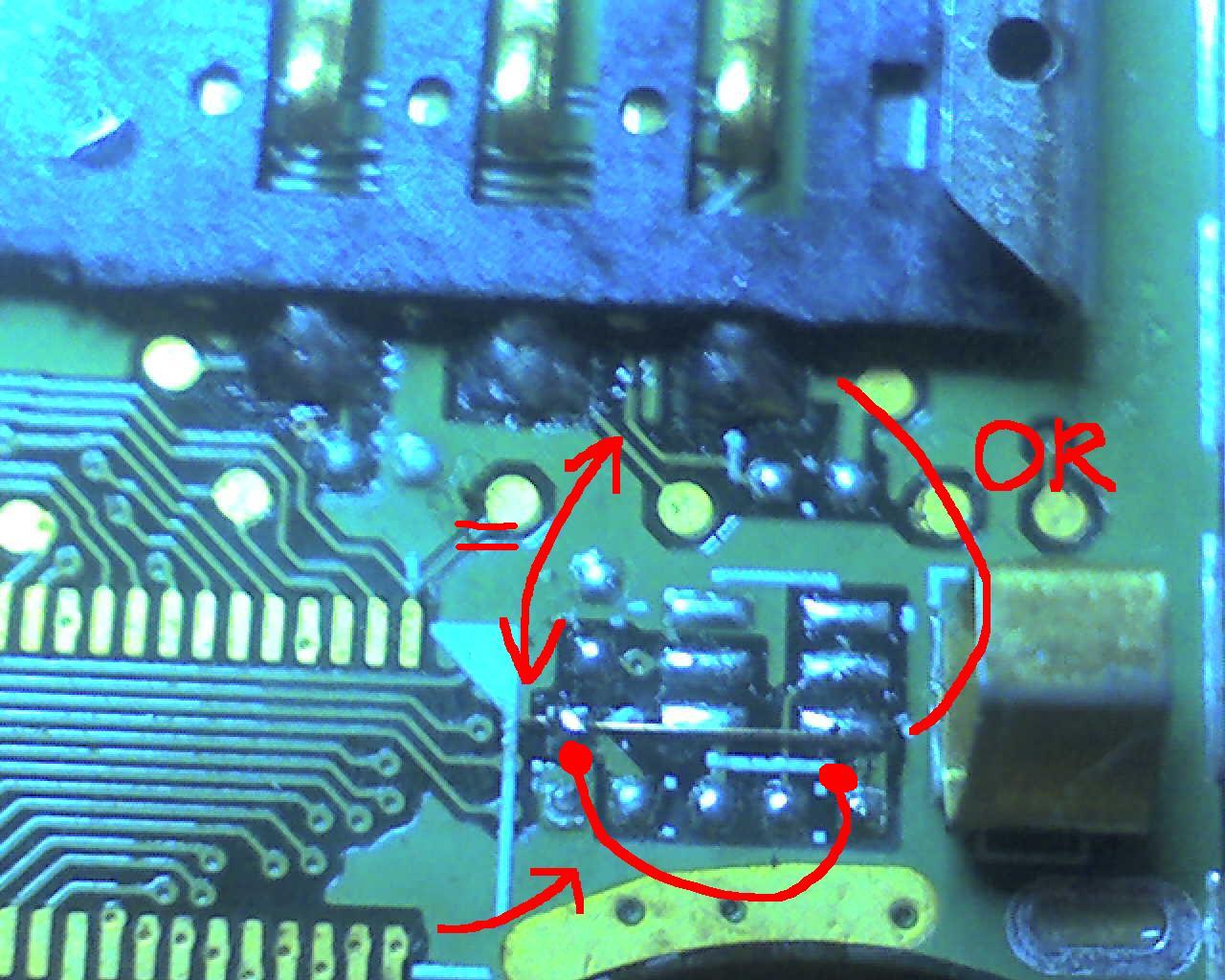

adisa 0 Report post Posted July 15, 2007 (edited) upgrade ur radio rom to ruim protocol version, setting ur qcn, place ruim connector to the tray, and solder it, make a jumper for ruim vcc. ready to use..... Edited July 15, 2007 by adisa Share this post Link to post Share on other sites
kshah 452 Report post Posted July 16, 2007 Mind posting details here? Where are jumpers in 6600? Share this post Link to post Share on other sites
gauravjc 47 Report post Posted July 16, 2007 @ adisa would appreciate if you post the pics where jumpers are located ! Thanks & hope to hear from you soon ! Share this post Link to post Share on other sites

adisa 0 Report post Posted July 21, 2007 (edited) its useless if u just make a jumper without other step done, im sorry that i cant post the step in this forum, its about ethic. basicly just like pdadev's post. if u will, u can pm me, but its not free. Edited March 1, 2008 by adisa Share this post Link to post Share on other sites
kshah 452 Report post Posted July 21, 2007 (edited) If it is not free then I am not interested thanks for offer. Once paid I believe one is free to distribute solutions. I have both boards so I will try to find out jumpers by comparision. Edited July 21, 2007 by kshah Share this post Link to post Share on other sites
adisa 0 Report post Posted July 23, 2007 (edited) If it is not free then I am not interested thanks for offer. Once paid I believe one is free to distribute solutions. I have both boards so I will try to find out jumpers by comparision. im sorry if i cant give u free, but as u know, its useless if only make a jumper or even upgrade ur radio rom with ruim version without setting ur QCN, wisthing ur time. i think u can get radio rom in the web, im forget the web. and maybe nextime i can post the pic for the jumper, i hope i got my time. the only think that make it dificullty is to restore the QCN file. if u have xv6600 which has "ruimed" that come from china (known as cu928, i think) u can "grab" the qcn file from it and restore to the xv6600 after u upgrade the radio rom, then u make a jumper, thats the steps. but, the problem is u cant connect the phone to computer with usb datacable. the only way is u have to use serial (RS232) datacable. its not so dificullt to make a serial datacable by ur self. u can visit http://pinouts.ru/PDA/pda_wallaby.shtml for ur learning. what next?? but then, u need a DM-tracker to make the phone switched to DM mode that make its recognize by computer. maybe u can collect the money with peoples in this forum to get the software. i hope its help. Edited March 1, 2008 by adisa Share this post Link to post Share on other sites

adisa 0 Report post Posted July 30, 2007 (edited) @ kshah this is the jumper bware!!! do not flash ur radio rom with ruim version if u cant restore the QCN with ruim version too!! it makes searching for network, no signal. bcoz it bcomes RUIM only. if happened, reflash with original radio rom, use MaUpgrade_noID. ESN the phone that "RUIMed" will be change same as in QCN file that restored. Edited July 30, 2007 by adisa Share this post Link to post Share on other sites
