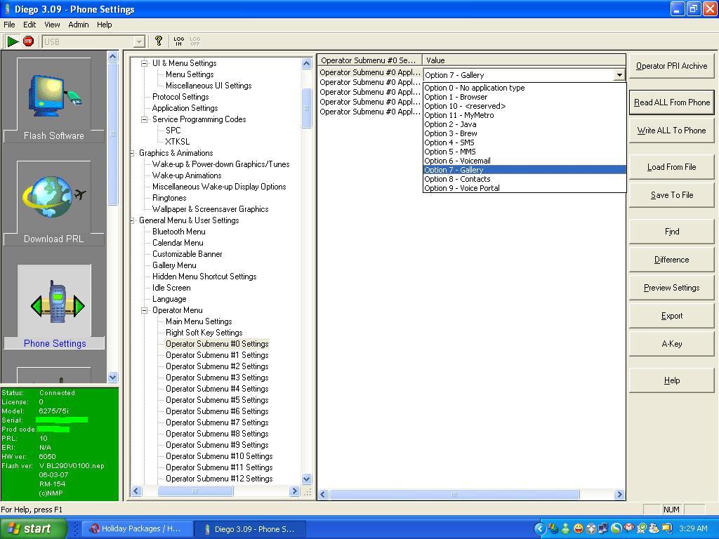

Puneet 0 Report post Posted December 22, 2006 Disclaimer: The following is for information purpose only, and you and solely you will be responsible for anything that you do to your handset. 1. You will need Diego to do this. Do not ask me where to get it, or for that matter do not ask on this forum too. 2. Connect your handset to the computer, and start Diego. 3. Go to Phone Settings --> Read All from phone. 4. Click on Save to File. Save the file in a secure location, Might be helpful to restore the phone to its original state if something bad happens. 5. In the PRI ID Settings browse to:Generic Features --> Menu & User Settings Features --> Operator Menu --> Operator Menu Settings 6. Click on Operator Menu Right Softkey Name, and delete R-World. 7. Click on Write ALL to Phone 8. Updated data will be written to phone, and the phone will restart, go into local mode, and then again restart. Do not disconnect the phone from PC while the process is underway. 9. You are done. Voila, Right Softkey is now set to Names (which is the default setting for Nokia) Aliter: Steps 1-4: Same as above. 5. Click on Find. In the box "Search for PRI Settings with ID" enter 1199 (This is valid for 6235/6155). Click on search now, Click on close. 6-9: Same as above. Share this post Link to post Share on other sites

raams 0 Report post Posted October 14, 2007 thanx buddy., I've succesfully changed my right key RWorld to Gallery.(screen-shot make it easy) how to change the R-World access in the main menu to Tatazone in 6275 Share this post Link to post Share on other sites
